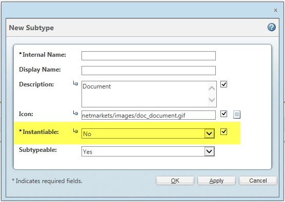

ScottMorris
Nov 6, 2017 2:39 PM UTC
As mentioned above, you need to make sure the Instantiable option is set to "Yes". It is "No" by default. Lots of good information on this in the Windchill Help Center.
