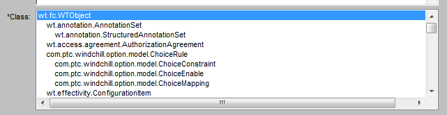

Is there some trick to using a newly created lifecycle template? I created a new one on our test system and have it set to enabled, but it’s not listed when attempting to reassign the lifecycle on an existing object. Is there something else I need to do?

90% sure it's this one: Is the new LC assigned to a type other than the root wtObject?

MikeLockwood sent me the answer.
"Is the new LC assigned to a type other than the root wtObject?"
Bingo. I didn't realize moving the cursor around in that list at the bottom actually did something. It just seemed like a read-only list.
