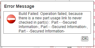

We have gotten multiple occurrences of the error: operation failed, because there is a new part usage link to never checked in part(s): Part --Secured Information. This error as occurred when truing to build WTPart structure and at check in. Any ideas what is causing it? How to fix it?

Quite a while late but there's now a support article on this: CS343227
We had this come up this morning and the issue was that userA had created some CAD and WTParts. The CAD was checked in but the WTParts were not and stayed as new in the user workspace.
Then a different user had an assembly that used the CAD parts. On checkin (with Auto Associate turned on), check in failed with the same error.
I found the offending parts by adding to workspace the CAD assembly and collecting all the WTParts. Two WTParts showed up on the collector page that were new.
I deleted those two from userA and then everything worked fine. Definitely a rare occurance.

I found very rare situation which can generate the error,
If the user create new WTPart in the workspace link this part with CAD part.
This part is added to the assembly which exist in the Commonspace
Then the Build structure (during checkin ASM) failed because WTPart exist only in the Workspace

Yes, in our situation, user had to find and checkin all sub wtparts in the assembly.
From the CAD perspective it was not clear for user.
Administrator had to help to find the wtparts to check in, because the sub wtparts where created only in the workspace of different user.
CAD model was already in the Commonspace without WTpart.
