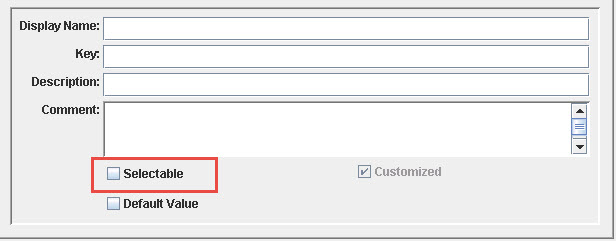

Jan 27, 2017 11:20 AM UTC
May be )
The new state must be selectable
Need to clear Tomcat cache <WT_HOME>/tomcat/instances
Rebuild resources

Jan 27, 2017 11:46 AM UTC
So it is selectable.
How can I "Need to clear Tomcat cache <WT_HOME>/tomcat/instances"?

Jan 27, 2017 4:29 PM UTC
In 15 years dealing with Windchill I've seen this exact thing asked 10,000 times.  The how-to is all there from PTC but buried pretty deep.  Would be nice to have a simple and concise cheat sheet of the top maybe 20 simple customizations like this.
When you save and then close enumcustomize, notice that is says that a process has actually occurred - and you can see the result in /Windchill/wtCustom/lifecycle/ - this file includes the states added using enumcustomize.  All states still need to be made available to the databse thru the .jar rebuild process noted above.  If curious, you can see the results of this in the database directly.
