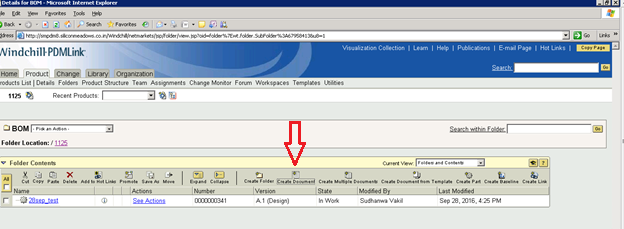

For new active products as well as for products for which new document creation was working in the past, currently the new document creation is not working (New WTPart creation and checkin is working fine)
Create a new WTDocument in the PDMLink folders using the following menu and upload a plain text document.
ERROR:
There is no trace in the Method Server log after this error (log attached) This was working in the past. Please let me know why a library is required if there is an active product and if this is a client related issue and how it can be solved.

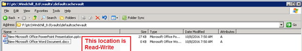

Looking at the Method server logs, you don't have enough space in the server.
Mon 9/26/16 19:00:18: RMI TCP Connection(19)-128.9.24.101: UploadContent.getContentFileOutputStream
Mon 9/26/16 19:00:18: RMI TCP Connection(19)-128.9.24.101: java.io.FileNotFoundException: G:\windchill_vaults\defaultcachevault\000000000d3096 (There is not enough space on the disk)
Mon 9/26/16 19:00:18: RMI TCP Connection(19)-128.9.24.101: at java.io.FileOutputStream.open(Native Method)
It may be something worth checking

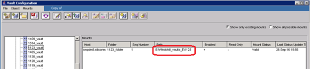

We are using E:\ as the Path for the product say for e.g. 1123 and there is 47GB free space in this drive.
The “defaultcachevault” in Windchill-loadpoint is RW and there is enough space on F:\

I am curious why the log file says G:, when you vaults are mounted on E
Are the logs taken from the same server
