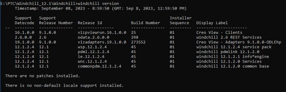

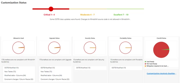

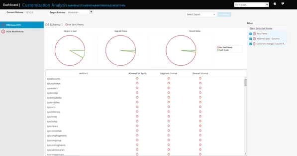

@sgaikwad31 ,
Thanks!  Next question.  I have an 'out of the box' install of Windchill 12.1 2.4 that I'm testing this on, and the assessment is telling me that there are hundreds of customizations present.  There certainly are not.  Will a later CPS trip up this tool?  The tool is claiming that my 'Current Release' is 12.1.2.0, but it's actually 12.1.2.4.  Would that possibly cause this behavior?
