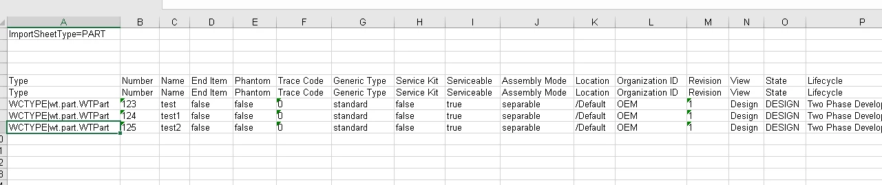

Hi ,
the part creation tool is used for system migrated from a CAD  centric plm like Intralink to bulk create related parts for existing CADs.
for your scenario I will rather use the import from excel .
you can create a dummy part manually and use export to spreadsheet to create a  excel model .
Later you can copy that model row with other numbers and change any attribute if needed like name .

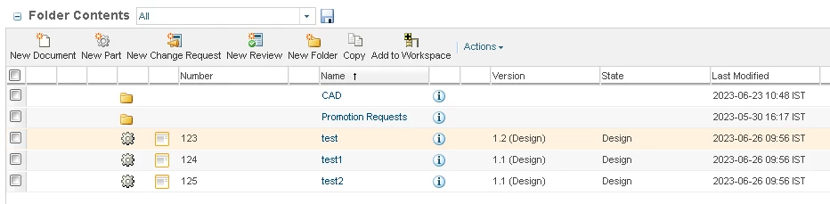

Hi Mr. Fadel
Apologize for the delay in response.
I add the new number in the export excel sheet after that I create a new number in the same sheet to import the spreadsheet into Windchill it's created. I want to test more on this. Thank you so much for showing me how to do it.
