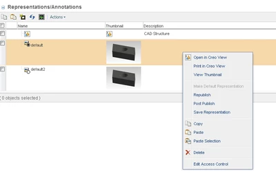

Hi there,
I recently switched from Windchill Essentials to PDMLink.
In Windchill Essentials the worker created several export formats according to the EPM-doc-type (pdf for drawings, step for cad-parts, etc.).
Though I did not changed "Creo View Configuration for Site"
(under Site->Utilities->Visualization Configuration Administration ), additional files under "representations" are no longer created.

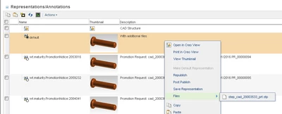

e.g.
a cad-part, which was released and published under Windchill Essentials, shows an available step-download
a cad-part, which was released under PDMLink, shows no step-file
where to start?

Hi @Mat
Have you set a xconfmanager preference to use publish rules?
It seems that the Publish rules are not used because the Description of the visualization do not contains the Publish rule description.
Check the
xconfmanager -s publish.usesPublishRules="ARBORTEXT MPMLINK GALAXY PROE" -t codebase\WEB-INF\conf\wvs.properties -p
description in article CS81396
