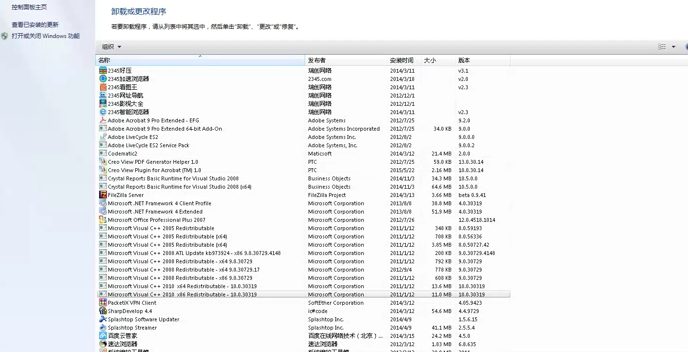

No thumbnails generated for Office file in Windchill PDMLink 10.0 M030
Custom environment:
OFFICE worker
version
Adapters(office worker)
Creo View 1.0 (MCAD,ECAD)_M030_Windows
Office(office worker)
Office 2010
AcrobatPro_9
AcrobatPro_9
LiveCycle ES2(office worker)
Adobe LiveCycle ES3 for JBoss_M010
The following has been installed:  please see the attachment: software has been installed.png
1. pview_batch\resources\acrobat\CreoView_Acrobat_Plugin.msi
2. Microsoft .NET Framework 4 Client profile
3. Microsoft .NET Framework 4 Extended
4.  Microsoft visual C++
Is there any reason for this issue ?
