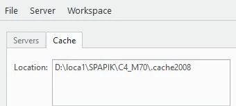

I would like to set our Creo4/WCH 11.0 system with multiple cache. I searched the earlier topics in this theme but there aren't clear exatly.
In the psf file have to define the next if i understood well :
ENV=PTC_WF_CACHE=D:\loca1\SPAPIK\C4_M70\
ENV=PTC_WF_ROOT=D:\loca1\SPAPIK\C4_M70\
ENV=PTC_WLD_ROOT=D:\loca1\SPAPIK\C4_M70\
ENV=CREO_AGENT_HOME=D:\loca1\SPAPIK\C4_M70\
SPAPIK is an user.
I didn't find anything else in previous descriptions .
Do i have to set anything else ? ( environmental variables )
We have an local active Creo2 and WCH10.2 system with multiple cache. It's work and we like it, but we have to move to a central system ( Creo4;WCH11.0). There are other server adress, other install configuration, etc.
We bought node-locked licenses and we can open more Creo4 sessions, but we cannot use more WS with the different sessions in the absence of the correct settings.
I need a little help that what did i set wrong.
