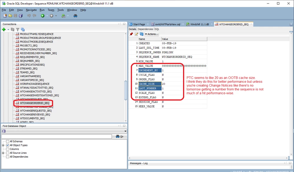

If you are using OOTB OIR for number generation and your standard is one task per CN there are three things I'd check.
1. Business Rule  Change Association Rules - PTC000007 cardinality.  Is it 1:1? (only one Task per CN)
2. db sequence WTCHANGEACTIVITYID_SEQ
3. db sequence WTCHANGEORDERID_SEQ
The sequences' CACHE_SIZE (which I'd set to NOCACHE), LAST_NUMBER and INCREMENT_BY should be identical. If they are but CACHE_SIZE is still the default (20). Set CACHE_SIZE to NOCACHE for both sequences.

18-Opal
Sep 22, 2020 1:23 AM UTC
Brain.
Are you using SQL Developer and some other app to look at the dB.
Here's a snap shot of the sequence from an 11.1 dB (11.2 and 12.0 look the same).
Note CACHE_SIZE = 20.
That said, if you have the rule set to 1:1 and they still get thrown out of synch if you create more that one task I'd say PTC needs to work on that.
In the meantime, I'd suggest not using sequence to generate the number.
I do like getting the number of the most recent CN and add 1 to it.
I set the OIRs for both the CN and the Task to key off the most recent CN number.  In short, because the code used to generate the number for both is identical the numbers for both have no choice other than to be identical.
I have not tested my code trying to create more than one task but I'd think you'd get a Uniqueness Exception regardless of the how the rule cardinality was set. And the CN number and the Task number would always be identical.
