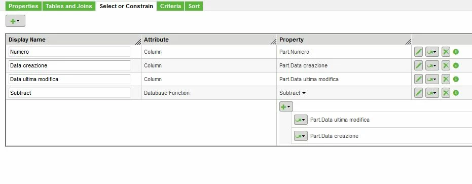

MarcoTosin
Sep 17, 2018 1:30 PM UTC
In the Select tab you can use Subtract function and then select two dates (for example Creation date and Last Modified).
See attached image (sorry for italian language but my browser is localized).
How many decimals do you see?
Marco
