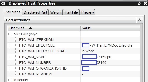

The issue we are having is that after checkin, the Name entered for NX cad name, does not go to windchill Name.
Upon saving of the cad file, the properties show PTC_WM_NAME & PTC_COMMON_NUMBER to be created depending on auto or not generating through epmdoc OIR.
OOTB is actually enters that value into Name, Number & File Name.
How can I set a preference, workgroup manager or ?? to pass the actual cad name ( that the user enters "Bolt, Hex, 1/2 in" into the NX Name file upon creation) into the windchill Name parameter?

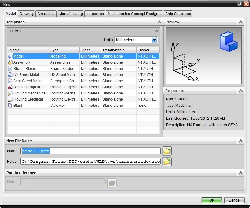

I just realized something, that I might not have realized because I have never been with a client that had NX & Windchill.
I was on NX, when it was UGI & UGII. Too long ago.
I realized that when you Select New from a NX session & it opens a window & you have a text entry field of Name (in the New File Name frame), it includes model1.prt (at least for this client & my install). So that means its wanting either Number or File Name, which will be the same in the end.
That model1.prt will be replaced with an auto numbered string.
So I am now wondering where the NX user enters the Common Name (I think that's the field in Creo/ProE) &/or Description.
Like "Bolt, Hex, 1/2 in". So this can eventually go into Windchill as Name.
From what I recall in Creo (because I don't have it installed on my laptop to check), when you start in Creo & have number auto generated, you get a screen with 2 text entry lines. Top will fill with auto gen number & 2nd (I think is Common Name), is where you enter the description "Bolt...".
So again, where should the NX user enter a description name "Bolt..."? In some NX property or parameter. Or edit/rename in the workspace, as its being checked in?

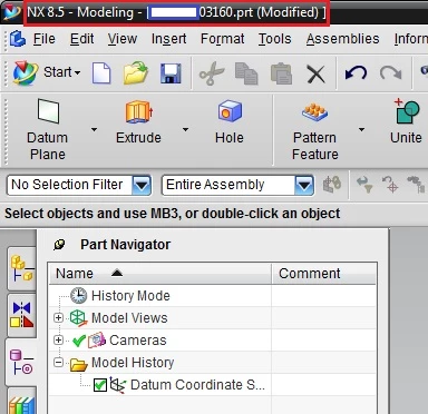

I also just noticed that after Accepting the default Name (model1.prt), it automatically applies windchill auto generated number &/or File Name XXXXXX03160.prt (as shown in 02 attached image).
After you save & view file properties, you can see where it has pulled & assigned windchill attributes (image 03).
It loads iteration, lifecycle, state, or id, rev, along with name & number (PTC_WM_..... for all).
Of course I like the Number (PTC_WM_NUMBER) being XXXX03160 without extension. But I am not sure if the PTC_WM_NAME is writing to Name or File Name & windchill makes one same as other. Then also which one the user can control, by entering "Bolt....". Then when the user enters "Bolt...", how do I get that to be the Name attribute Value in Windchill.
