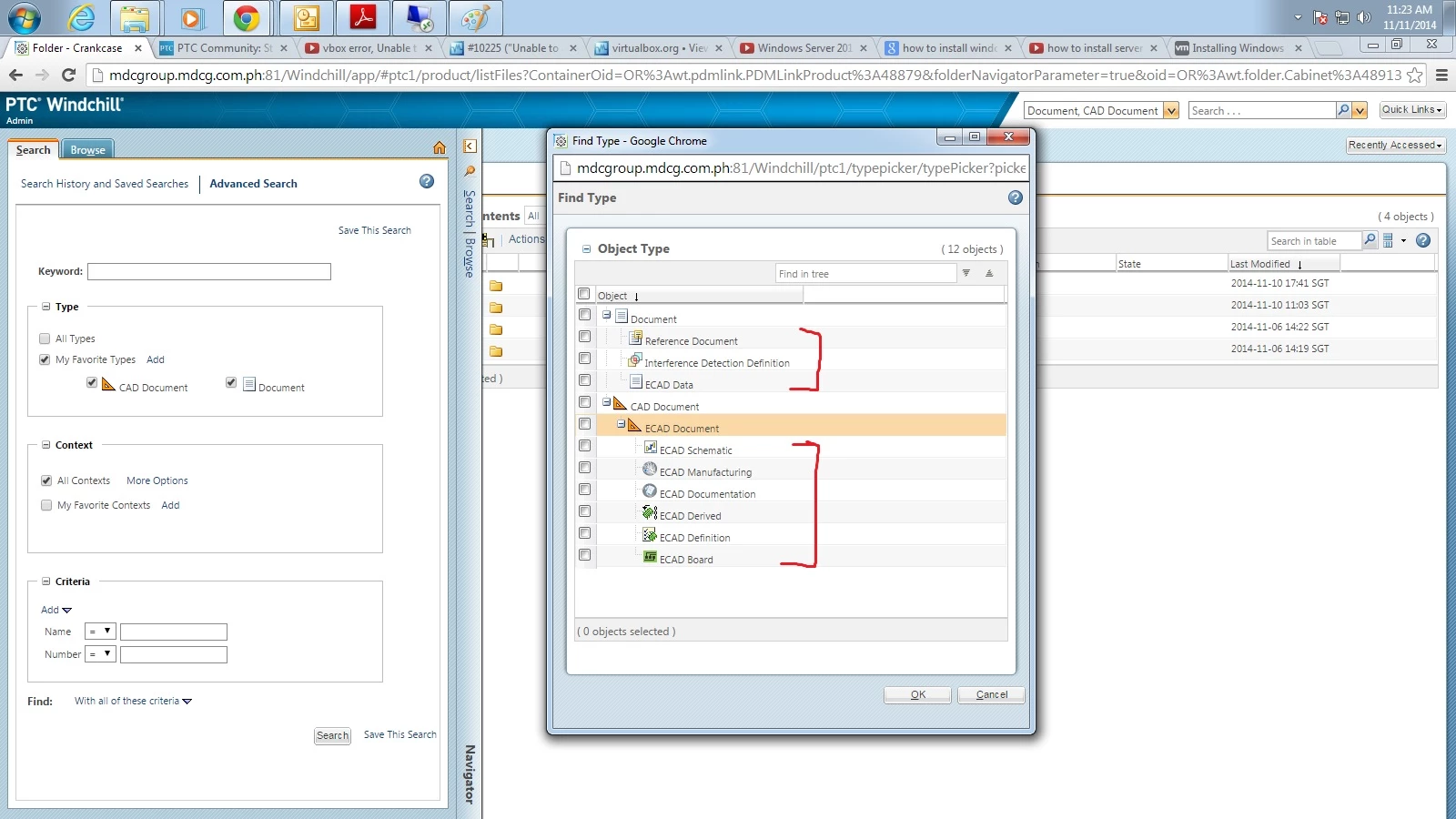

In the advanced search, there's a ADD in object types. Please see the attach image.
Is there a way to add object type? like in the highlighted picture in the image. If yes, how? can you teach me?.,
Thanks in advance!

Hi! thanks for the reply.,
yes, I want to add more type of object., because what I've shown is the default from windchill.

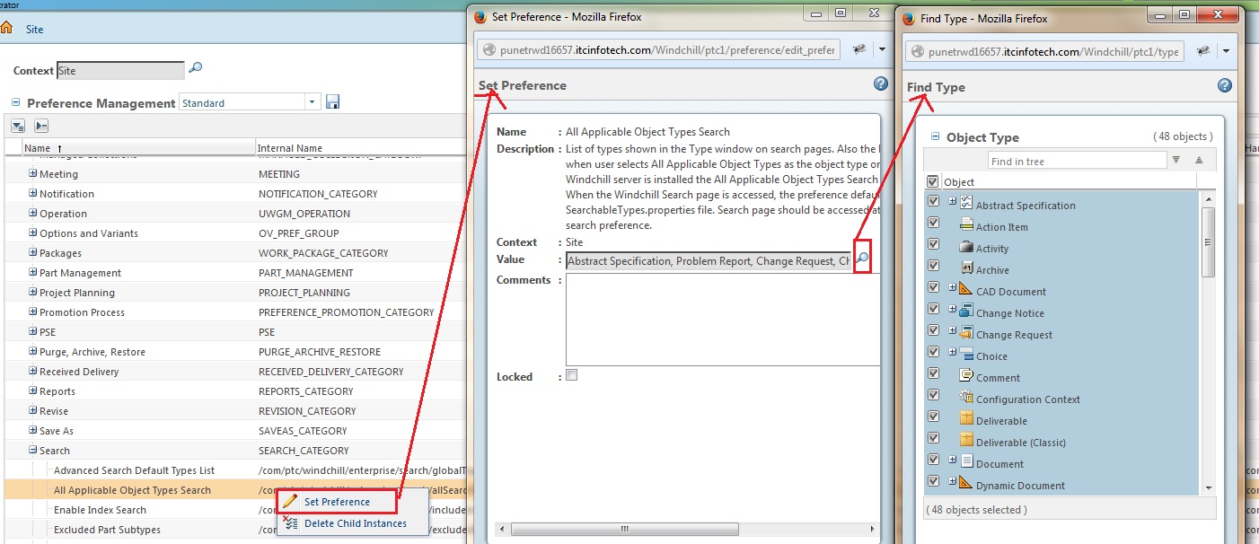

Can you check if the new object types that you want to be made available on the object type picker on the search page are available at :
Site-->Utilities --> Preference Management-->Search --> All Applicable Object Type Preference
As shown in the above screenshot. If you can see your type on the above object type picker but is unchecked, select it and click on okay. This will update the preference and subsequently the type will also start showing on the object type picker of the search page.
However, if the object is not present on the type picker of the all applicable object types preference itself then you'll have to make an entry in the searchableTypes.properties
What is your object type that you wish to add to the object type picker on the search page ?
