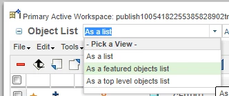

Hi @cdiaz-2
Do you use default Object List view As a list ? or different?
Because your description reminds me that the view is set to "as a featured objects list",
description in a help Link to the Help
generally only specific objects are displayed. so undoCheckout can issue that objects are not displayed in a list
Displayed objects:
• been initially selected for Add to Workspace or Check Out actions.
• been previously checked out.
• been modified, either locally or in the server-side workspace.
• drawings included for objects already selected.
• been previously opened in the CAD tool

correct i use the default "as a list" option
when its gone i mean its gone as in "search in table" wont find it and if i do file open and use *partnumber* that doesnt find it either, its gone gone.
and just to clarify, it doesn't matter if i do undo checkout from the model tree with the files in session or if i do it from the workspace. most of the time those objects that i performed undo checkout are removed from the workspace.
