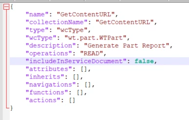

1- Below is the json for navigation :-
2- Added navigation in Parts.json

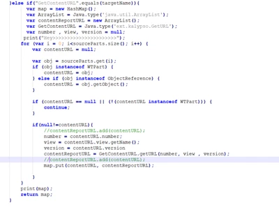

3- Calling custom method in Parts.js for this navigation ;-

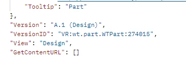

4- Response is coming as below :-
