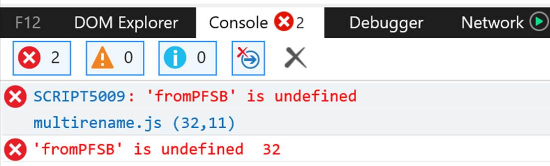

Since this morning, when I want to rename a CAD document, the button "OK" doesn't work. I can click but nothing happen, the window doesn't close and the rename is not done.
Saturday, an installation of optional components has been done (ProjectLink, MPM Link...) and the problem was not present before.
Do you have an idea ?

This sounds like a cached javascript issue. Clear your browser cache, reload the Windchill page and try again.

Unfortunately it is not. I've already tried to clear all the caches but it doesn't work anymore.
I checked in developer mode for Internet Explorer, and when I click on OK, I get this:
