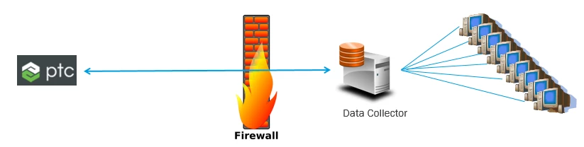

I am working on defining the requirements for an onsite collector for Creo Performance Advisor.
So Far I have
  • Enable every user to connect to an onsite collector enabling only one connection back to PTC

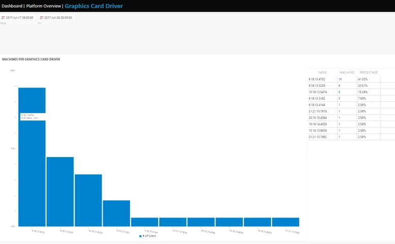

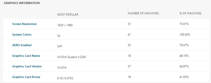

would it be possible to also get Graphics driver version?
Sounds gr8 that you can group data.
MarcoTosin
Jul 27, 2017 11:59 AM UTC
You have already that information under Platform Overview (see attached images)
