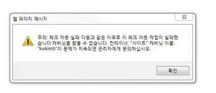

Would you please help on my Korea customer’s new user can't  checkout objects issue ?
Customer environment : 10.2M030CPS10 windows OS (dev server)
Issue : All new created user can’t check out  WTDocument and WTParts with below error .
Checkout failed with below error
The cabinet could not be found. Container: "Site" Cabinet name: "xxxxx"
 check out error
TS done :
1.Added full control permission but still failed check out
2.Follow the https://www.ptc.com/en/support/article?n=CS19027
     Run Winru -Fix CabinetBased Data Container Alignment  and Windu -CabinetBasedDataContainerAlignment
But still can’t resolved the issue
In DB, found that all new created users’s  classNameKeyContainerreference values  is  Wt.pdmlink.PDMLinkProduct  IDA3CONTAINERREFERENCE  85020
Normal user’s classNameKeyContainerreference values  is wt.inf.container.ExchangeContainer  IDA3CONTAINERREFERENCE is 5.
So try  replace new user’s  classNameKeyContainerreference and IDA3CONTAINERREFERENCE
To  wt.inf.container.ExchangeContainer and 5 then all new created users can able check out all objects.
Does anyone have similar experience or suggestion the issue ?
