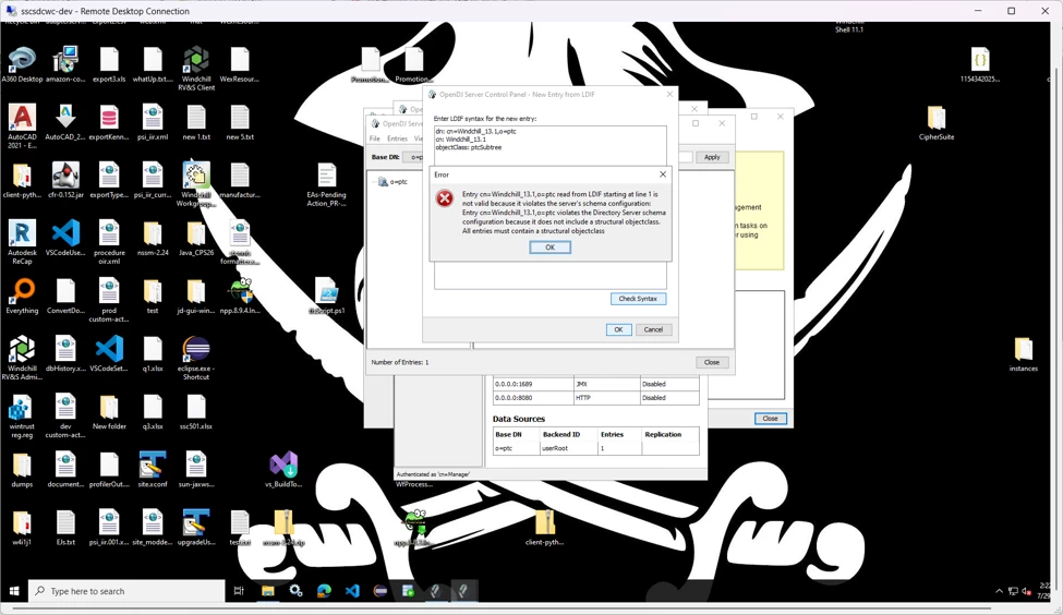

Was wondering if someone has used a newer version of OpenDJ instead of the older PTC supplied 11.2 version. I downloaded the newer OpenDJ, but am unsure of how to set it up to mirror the 11.2 version. Many thanks in advance!

be aware using o=ptc did not work for me
5.On the Directory Data page, in the Directory Base DN box, type o=ptc (this can be any custom Base DN such as o=abc). Select the Only Create Base Entry option and click Next.
Use below for the directory base DN or the install will fail!!!
ou=people,cn=AdministrativeLdap,cn=Windchill,o=ptc
As highlighted in the call below
https://www.ptc.com/en/support/article/CS349396

o=ptc works fine as long as that is what the existing (source) ldap uses as the base entry.  If you’re existing system uses something else, then match that.  Importing the ldif file from the source ldap server will build the rest of the structure.  See https://www.ptc.com/en/support/article/CS392017

Followed the instructions, but get error when following CS352917:
Jul 30, 2026 4:11 PM UTC
If you have an LDIF from WindchillDS to import there’s an option in opendj to reject non-compliant entries which you can untick, then after the LDIF is imported you delete those entries that didn’t fit the schema
Aug 4, 2026 9:57 PM UTC
are you doing an upgrade? fresh install?
if its an upgrade then you need to use same the directory base DN path from DS
