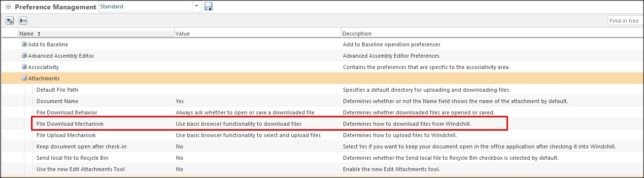

Opening data.wcdti or downloading a file from IE is downloaded DTIActionServlet.servlet instead the required file
when i'm downloading a file from Windchill with desktop integration activated (using Internet Explorer) download a file named DTIActionServlet.servlet instead my file.
If i disable desktop integration in my setting is working but i need it.
Using Firefox it's the same. FF download a file data.wcdti, opening that is download same file DTIActionServlet.servlet.
This happen with any files.
Do you have any suggestion?

Nov 16, 2015 2:49 PM UTC
Open Quirc Links > My Settings > Preferences and verify the highlighted setting.Snap0170.jpg
acurcio1-VisitorAuthor
Nov 16, 2015 3:31 PM UTC
I can't disable it. I need desktop integration
