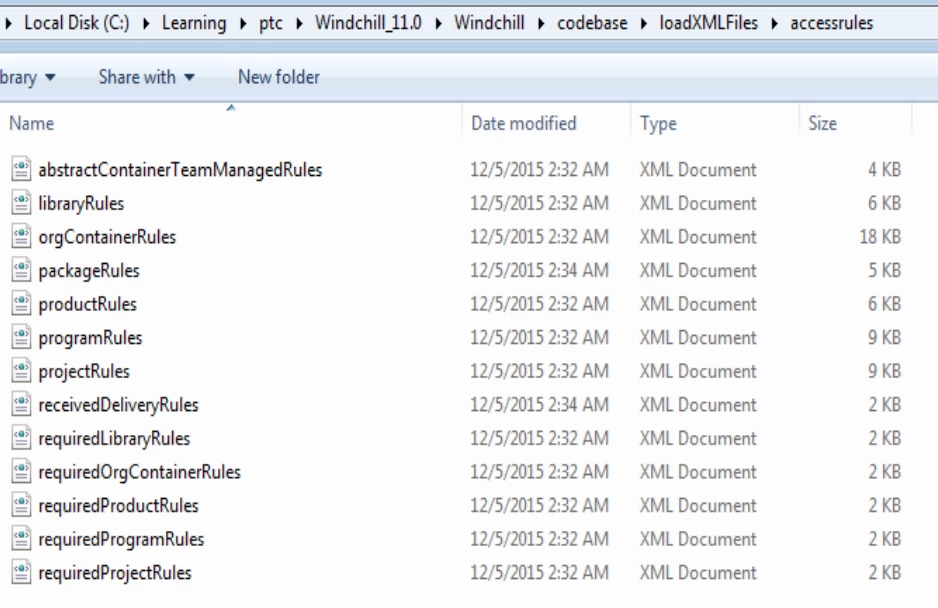

I am using Windchill PDMLink Release 11.1 and Datecode with CPS F000-CPS01 Facing an issue during creating the organization in windchill 11.1 Here are the errors that I faced \accessrules\orgContainerRules.xml (The system cannot find the path specified)

Hi ​@RK_14581645,
The post headline mentions an organization creation issue. however, the path specified appears to be related to Access Rules.
What exactly are you trying to load?
The error clearly indicates that the path being passed in the command does not exist.
May 11, 2026 6:53 AM UTC
Hi, the system is complaining from a missing file, check that the mentioned files exists under $WT_HOME/loadXMLFiles/accessrules
May 11, 2026 8:41 AM UTC
These are the file are exist

Caused by: (wt.ixb.publicforhandlers.ixbResource/8) wt.ixb.publicforhandlers.LogHelper$IxbException: Problem in export/import process.
Nested exception is: java.io.FileNotFoundException: \accessrules\orgContainerRules.xml (The system cannot find the path specified)
