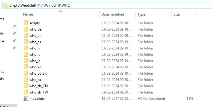

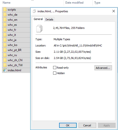

When I installed Windchill, I selected two languages: English and German. But I discovered one folder in which I can see all other languages. therefore my question is that there are now 2 lakhs of files in those folders, which Windchill can read when it is launched or run, therefore the reading time is high, can we delete any folders other than those two? It will not be affected in Windchill Right.

    Feb 7, 2024 9:32 AM UTC
    This is my screenshot.
    HelesicPetr
    Feb 7, 2024 9:38 AM UTC
    Hi @Amirtharaj_K
    It depends where the folders are located.
    The deletion can affect a browsers that use a specific Language setting and this files are used even though you install just two specific languages.

    Feb 7, 2024 9:52 AM UTC
    Thanks for the replay Mr. Petr,
    @PatH: Kindly find screen shot below.
    You mean we can't delete the other language file because it'll affect both Windchill and the browser, am I correct?

    HelesicPetr
    Feb 7, 2024 9:54 AM UTC
    Hi @Amirtharaj_K
    This Is just Windchill Help Center, and yes it can affect the Help pages.
