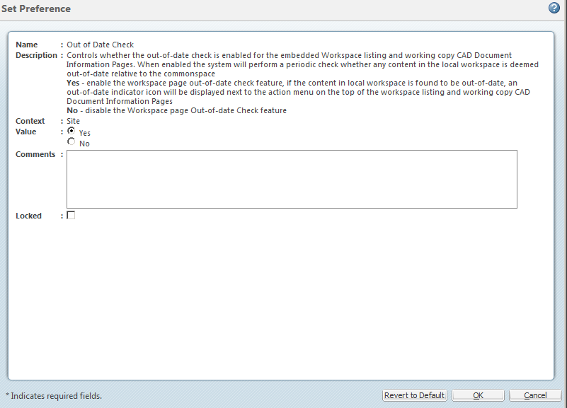

Wondering about the preference available at site level, in the workspace section, called "Out of Date Check":
I set it to "yes" so that users would be notified about out-of-date objects, as the following screenshot teases:
https://thingworx.ptc.com/apps/solution_preview/solution/lang/presolution?lang=en&n=CS47173
(Which shows a clock icon at the top of the table near the "Pick an action" drop down)
But the preference doesn't seem to have any effect for me and I haven't been able to see this aforementioned out-of-date icon.
This is what I tried:
Using Creo 2, connected to Windchill 10.2 using the internal Mozilla browser.
Added a revision 0.1 model to my workspace.
Another user checked out this model, modified it and checked back in; Commonspace now is at 0.2.
My workspace shows no notification, even after I wait 5 minutes, nothing happens; I try to refresh the page -nothing...
does anyone know if this functionality could be working for us ? We use Windchill 10.2 and Creo 2.0.
Maybe I'm not expecting it to work the way it is intended...
Is there is there some auto-refresh setting that I am missing?

I also tried this preference and functionality but I have to say that it doesn't work.
