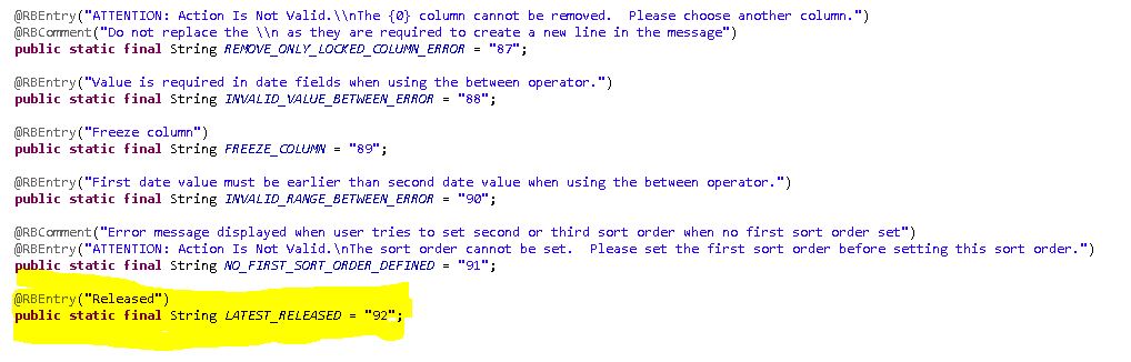

hello,
I need to add one additional option under a drop down. These drop options are read from a RBinfo java file. I am updating this java file manually updated it and compiled it. When i decompile the Class file i do see the new entry in it. But it does not reflect in the Drop down. I am working on Windchill 10.2 M020. I am wondering if there is any change in the functionality of RBinfo file customization for 10.2. However i was not able to find any thing new in Customization guide for 10.2.
This resource bundle is com.ptc.core.htmlcomp.createtableview.createtableviewResource and used for Find Affected Objects.

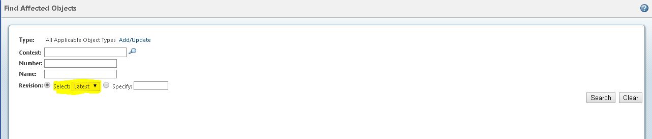

Below image, I want to add additional option under Select option.
Please let me know, if you anyone have any information on this.

To update OOTB annotated resource files you should use resourceCustomize.rbInfo (the file contains instructions).
If updates need to made for other languages use the appropriate resourceCustomize_<language>.rbInfo file.
