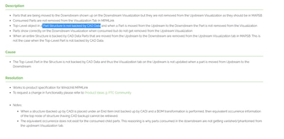

I found an article describing my exact issue Link However I do not know how to fix it since I don't understand what "Part structure not backed by CAD data" means, could someone elaborate a little on the matter, please?
So far it seems to happen for every assembly I try to transform. Upstream/downstream visualization does not update when changes are being made to items.
Some assembly components' 3d model visualization is absent in the QA session, could this be the issue? How can I push Worker to generate all the necessary thumbnails and visualizations for certain assemblies? (They're set up to generate automatically server-side, but I'm not an admin so I'm looking for a workaround)

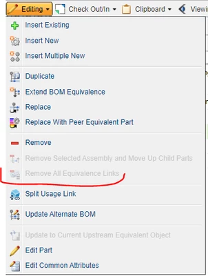

Which settings are responsible for enabling the "Remove All Equivalence Links" option for users?

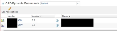

I believe what its saying is that there is not a linked CAD object to that Part. You should see a CAD object linked on Related Objects with a type of Owner or Image. That should allow visualizations to be shared or published to the related Part.  What does it say on that page?
As for the greyed out action, it could be a license issue or the state of the Assembly which greys it out.  You can try adding &jcaDebug=true to the end of the URL and there should be a red bug that appears next to the action. It should tell you why its greyed out. Some validation kicked in to deactivate it.

Thanks for a quick response!
As to the 2nd point - I can't. It's in the MASPB window and the URL is static.
I doubt it's license related. I have MPMLink module license, I can do pretty much everything and I can remove equivalent part links one by one under "Equivalent Parta" tab on mBOM side. But its tedious...especially now that I'm playing with it for the first time. I think I've read it's role-related issue (privileges).

Solution to allow Remove all equivalence links is described in an Article cs284926
PS: only Manufacturing Engineering Manager works in Wch 12.0.2.2

In my opinion the issue appears if the CAD model is not correctly connected with WTPart object.
For example, CAD has been created by check-in without WTPart.
The WTPart was connected without build function. so there is just link.
Then the behavior can appear.

So article CS298065 is right that the CAD data is not correctly connected to WTPart (even though it's present and fine as far as assembly CAD data is concerned).
In order to build the CAD data for WTPart I went into the Compare to CAD data tool in the WTPart in order to "Build Multi-Level Part Structure"  but I was met with an error related to multiple parts preventing me from doing so. Article CS121264 describes that.
Turns out that my company moved from ProE a few years ago to Creo 7.0 and some parts have legacy parameter (sheet metal) which prevents parts from check-in. I had to open those parts in Creo 7.0, remove this parameter and check-in.
