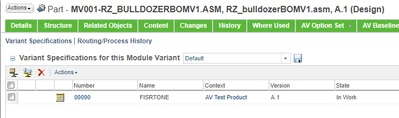

I don't know if I have correctly understood your requests, the below mapping can be used to show the related Variant spec on a the variant page as alias attribute :
roleAObject@com.ptc.wpcfg.doc.VariantSpecVariantLink~roleBObject^com.ptc.wpcfg.doc.VariantSpec

Unfortunately this can show you just the specification where the variant BOM has been generated.

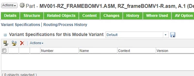

If the BOM contains generated sub Variant parts, they are not linked to the specification directly.
assembly where the BOM has been generated shows the specification
sub variant does not.

you are right , there is no link directly between the child parts and the VS .
