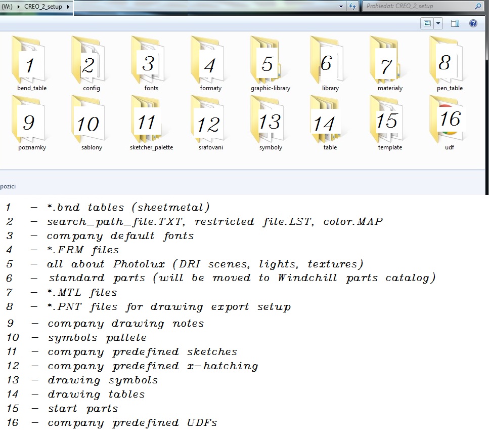

Hello all,
in short: What all should be included in Windchill parts catalog?
l´m absolutly sure about:
- start parts
- formats (*.FRM)
- standardized parts (screw, washer...)
Up to now we have worked without Windchill and we have used "shared unit" W:Creo_setup as a storage place of our company standards. In generall all was driven by config.pro options.
Could you give me some tips please?
For example:
Include UDF´s into parts catalogs, because ...
My idea is:
Will stay using config.pro option. l will move UDF´s into parts catalog in future when l will dicover some reasonable reason.
What l´m afraid:
Has to be something included from first start of Windchill?
Thx for every tip or trick...

It depends on everyone choice. There is no different between load company data from Windchill or from a company net.
TIP:
If you wanna load formats from windchill, you have to change config.pro option.
pro_format_dir wtpub://WCH_SERVER/Libraries/formats
It´s stricly recommend to have the same name of server at all workstations ---> from the reason of config.pro distribution to other workstations.
Hope it will somebody helps...
