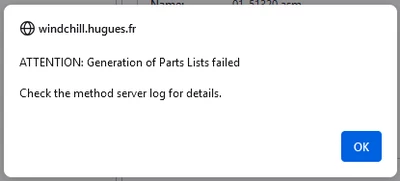

Window error pop when select "generate parts list" with message :
ATTENTION: Generation of Parts Lists failed
Check the method server log for details.
Error in method server log file :
2025-07-23 14:26:22,421 ERROR [ajp-nio-127.0.0.1-8010-exec-4] com.ptc.arbortext.windchill.partlist.StandardPartListService demo - Unable to load attribute iterationInfo.state: Unable to get value of attribute WCTYPE|com.ptc.arbortext.windchill.partlist.PartList~MBA|iterationInfo.state from com.ptc.arbortext.windchill.partlist.PartList:com.ptc.arbortext.windchill.partlist.PartList!

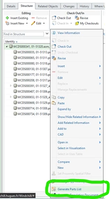

Hi avillanueva,
Right click on parts list in top part on structure panel then "generate parts list" :
Result :
avillanueva
23-Emerald II
Jul 23, 2025 2:16 PM UTC
I am not seeing that action in my install. I see in the logs it refers to arbortext. Does anyone know if this action is related to a special module added to Windchill? Would you mind sharing what modules you have installed?
