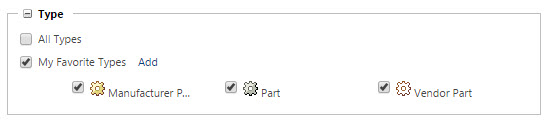

Hello All,
Can someone help me out in enabling the below options:
In PartsLink for search based on sub-types.
Regards
Bharath Kumar

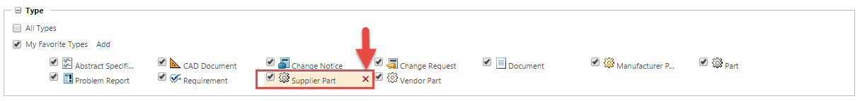

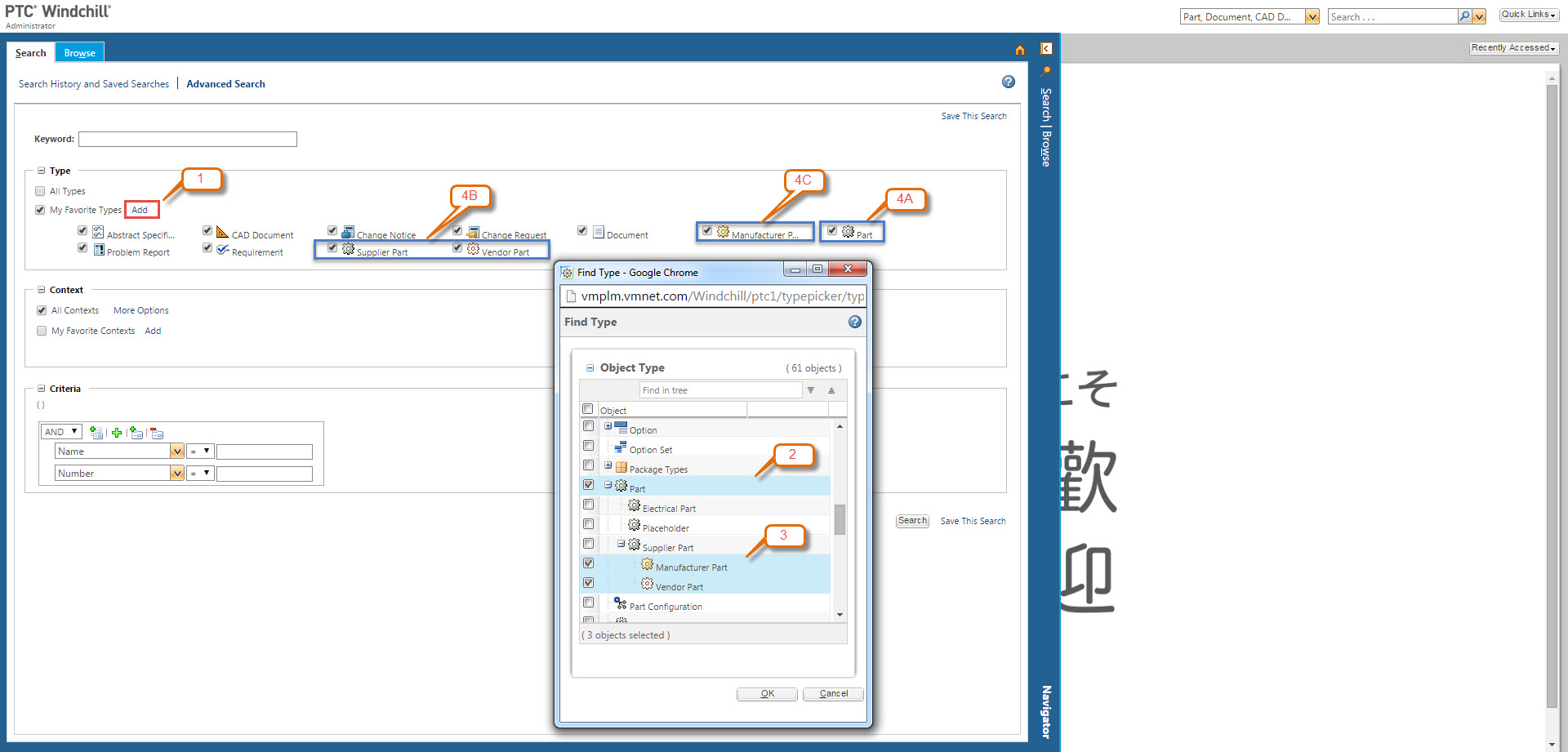

Brarath - For which exact release of Windchill?
I've tested using Windchill 11.0 F000 and I can easily select Part and SUMA sub-types (illustrated screenshort containing storyboard below)
If for any reason you need to remove some types or sub-types from the Tpes list, you can navigate the selected type/sub-type (using the mouse), wait a bit until the red cross appears and use the red cross as much as you wish on any type/sub-type so that to filter your own list to match your specific requirements
This way I have been able to filter my favorite Types according to your original screenshot
For what is related to the appearance order, I guess this is related to an alphabetical sorting (Manufacturer Part comes before Part and Vendor Part after Part)
HTH!&VBR/H

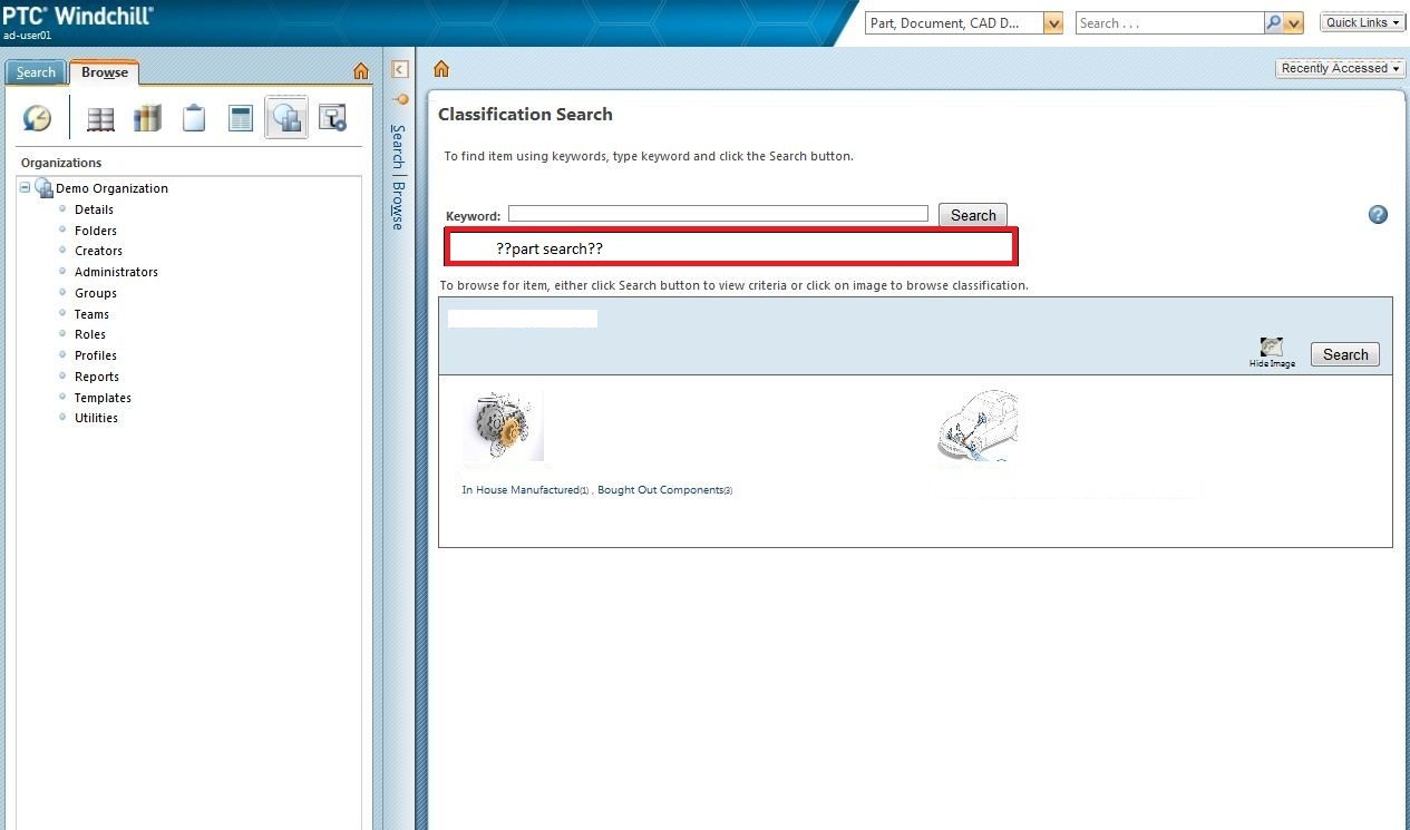

Hi Abat
Sorry for being not specific, I was talking about Windchill 10.2 M030 and my question was about Classification Search.
The snap shot below should help you in what I am looking for.
Thanks for you help!

Dec 30, 2015 2:33 PM UTC
Bharath - It seems that Classification constraints with namespace com.ptc.csm.default_clf_namespace is not defined on Part type or its defined on a sub-type of Part.
May be CS145965 can help?
