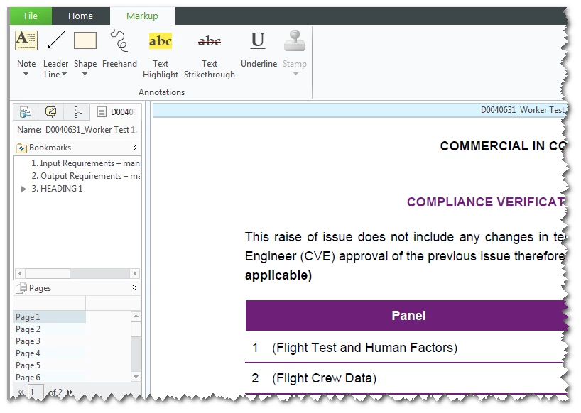

I can certainly confirm that it is greyed out in our system. I difference might be that you are publishing a EPM drawing as a PDF. That may be supported without this license. I am publishing WTDocs or WTDocs whose primary content is a PDF. The icons are greyed out. It was explained to my in licensing discussions that this license enables those markups on Docs to be active. Can you try opening a WTDoc with a PDF and see if it greys out the icons when you view that?

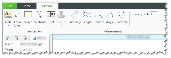

Apr 6, 2022 2:55 PM UTC
It's the same markup tools for docs (PDFs)

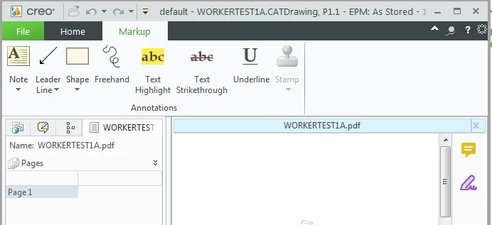

When marking something that's not a pdf the tools are a little better, but not much
What does PDF collaboration add?
