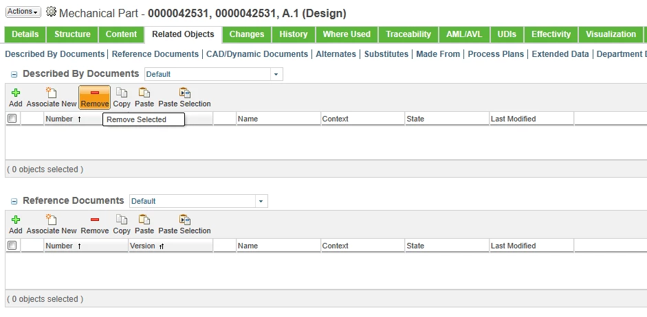

Hi Guys,
Can we use the CAD Worker to publish the .drw into PDF after that can we get into "Described by Documents / Reference Documents".
WT Part is already linked with CAD .prt + .drw.
Please find the below image.
Aj

There are a number of places you can put that published PDF. I have ours going as a secondary file for the representation. Works well with Thingworx Navigate. I've seen people put it was secondary content to the EPMDocument which makes it easy to download from the Content tab of the drawing. You are asking to create a WTDocument with the PDF and link to the WTPart. Yes possible.
https://www.ptc.com/en/support/article/CS348518?source=search
You should investigate the AfterEDRLoader and make you customizations there. I would caution from a Config Management perspective, you are setting up a data management nightmare. You now have possible two sources of truth, the CAD drawing and the WTDocument. Its possible that they become out of sync. My advice it to keep things packed to a single object.

Thanks for the replay Mr. Avil,
I refer your your article it's really useful to me, but i want that pdf in WT Part. Here only we have EPM & New Document.
Can we do this same in WT Part.

Hi @Amirtharaj_K
It is possible if the CAD exists to do so with the AfterLoader but you need to rewrite it that PDF is saved on the WTPart.
