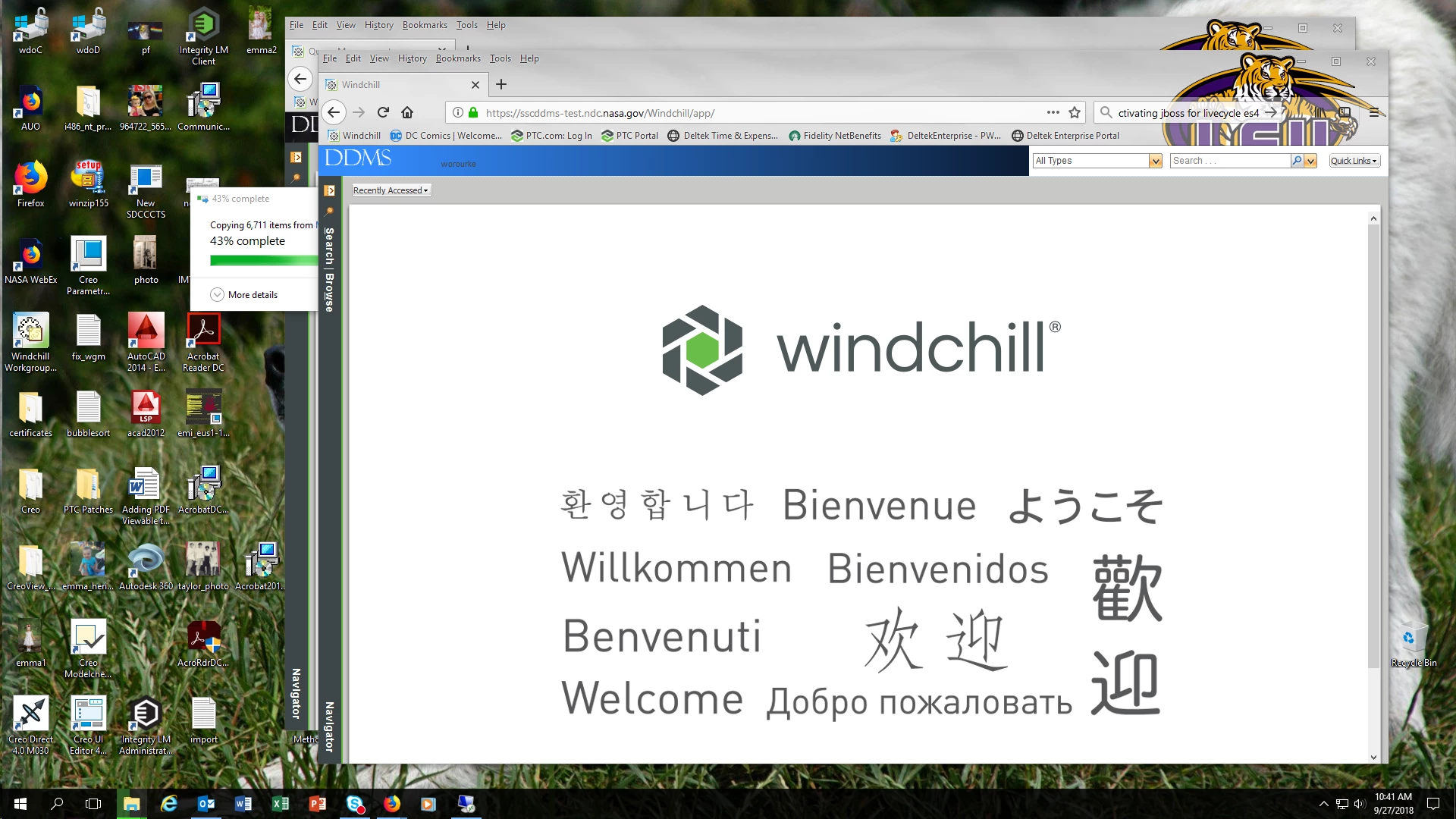

PDMLink 11.0 M030 CPS12 - Recently Accessed Button shifted
Has this happened to anyone who has installed CPS12(see attachment). Thanks!

Have you made any changes in OOTB Windchill\codebase\netmarkets\css\windchill-base.css file?
Recently Accessed menu is rendered through below tag from windchill-base.css file.
.x-box-item {
position:absolute;
left:0;
top:0;
If left tag is not available then image may shift to extreme left corner?

We have, but discovered that the PSI Installer did not completely compile some java fragments, and when we reran it, all was good. Many thanks for your help!
