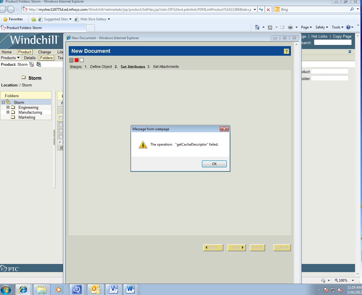

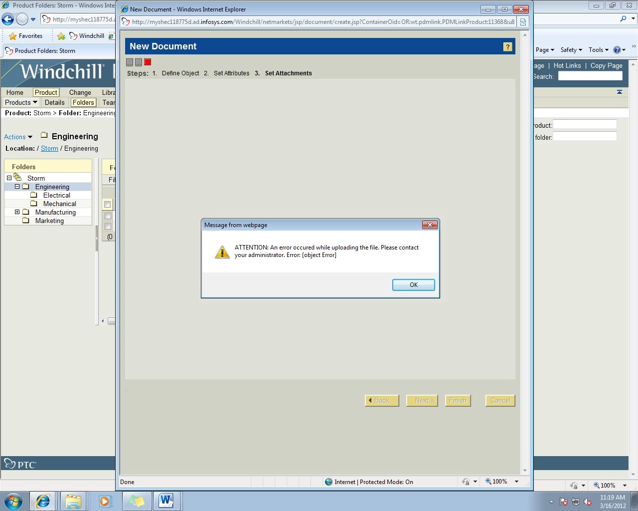

I am accessing windchill pdmlink from a client machine. I am facing some issue while attaching document to the document object from client machine but not in the server machine. From server machine, I am able to attach document, but not from any client machine. Please check the attachment and help me.
Error 1 : Attention : An error occured while uploading the file. Please contact administrator. Error (Object Error)
Error 2 :The operation : "getCacheDescriptor" failed.

Hi Raghuram,
First thing would be to check if there is any Antivirus on the server, if
yes try stopping the services. If not, then on the client machine try
deleting the Java Cache from Java control Panel 'Remove Temporary' option.
Then clear browser cache and restart the browser to try.

Hi Raghu,
I have seen this issue before.
Clearing Java cache and browser cache should work.
Follow the instructions below:
1. Clear the Java cache on the client:
1.1 To clear client Java cache go toStart > Settings > Control Panel > Java (Java Control Panel)
1.2 UnderTemporary Internet FilesclickSettings...and then clickDelete Files...
1.3 Ensure theApplications and Appletscheck box is selected and clickOK.
If the above does not solve your problem then try doing below mentioned steps:
2. Use Browser upload instead of Applet upload by changing the upload preference in the Preference Manager:
2.1. Go toHome > Utilities > Preference Manager > Attachments
2.2 SetFile Upload MechanismtoUse basic browser functionality
Karan Narang

Unfortunately, this error can have many underlying causes and gives no
indication as to which is involved.
Several of the security fixes in Java 6 update releases were disruptive
and caused issues with Windchill clients. One or more of these can
cause such issues with the document management applet as I recall, so be
sure you have the latest patches from PTC to address this.
