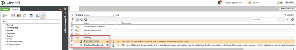

Hi @AZ_10746014
Windchill has a similar report
Rocket_Max
Oct 25, 2023 8:51 AM UTC
Hi @AZ_10746014
3-Newcomer
Oct 25, 2023 9:06 AM UTC
But through this report, I still can’t get the SQL I want. Can you share the relevant SQL statements with me? Thank you.

Hi @AZ_10746014
SELECT
a0.percentworkcomplete,
to_char(a0.startdate, 'dd mm yyyy hh24:mi:ss'),
to_char(a0.actualstartdate, 'dd mm yyyy hh24:mi:ss'),
to_char(a0.finishdate, 'dd mm yyyy hh24:mi:ss'),
to_char(a0.actualfinishdate, 'dd mm yyyy hh24:mi:ss'),
a0.totalcost,
a0.name,
a0.plannablestate,
a0.classnamea2a2,
a0.ida2a2,
a0.classnamea2a2,
a0.ida2a2,
a1.namecontainerinfo,
a0.risktype,
a0.healthstatustype,
a0.classnamea2a2,
a0.ida2a2,
( a0.millisduration ) / ( '28800000' ),
( a0.millistotaleffort ) / ( '3600000' ),
( a0.millisdoneeffort ) / ( '3600000' ),
( a0.totalcost ) - ( a0.fixedcost )
