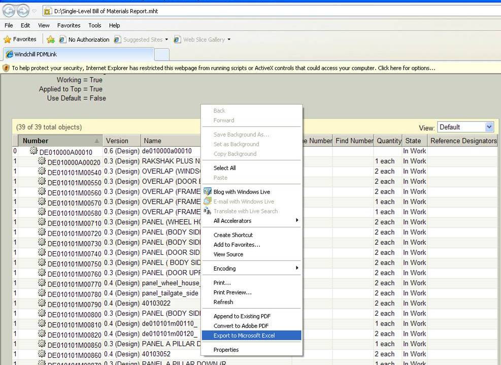

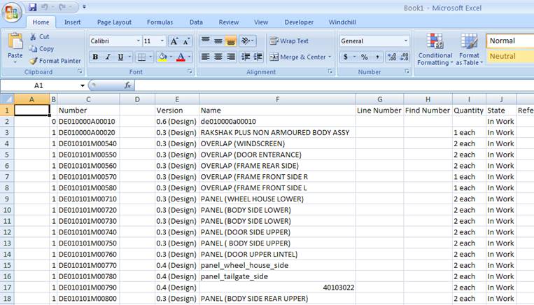

Jan 16, 2012 1:43 PM UTC
Hi
There are two other similar ways also available to export Reports (Multi level BOM, Multi level Where used etc)
If option in not available
1. In the table of the Report right click and you will get an option export to microsoft excel
This will ask you later step to select the table
2. Save the Report webpage in .mht extension and again open in internet explorer
Now right click and export it to microsoft excel(with active x desabled)
These options give the table in proper size and no object is selected
Regards
K.Mahanta
