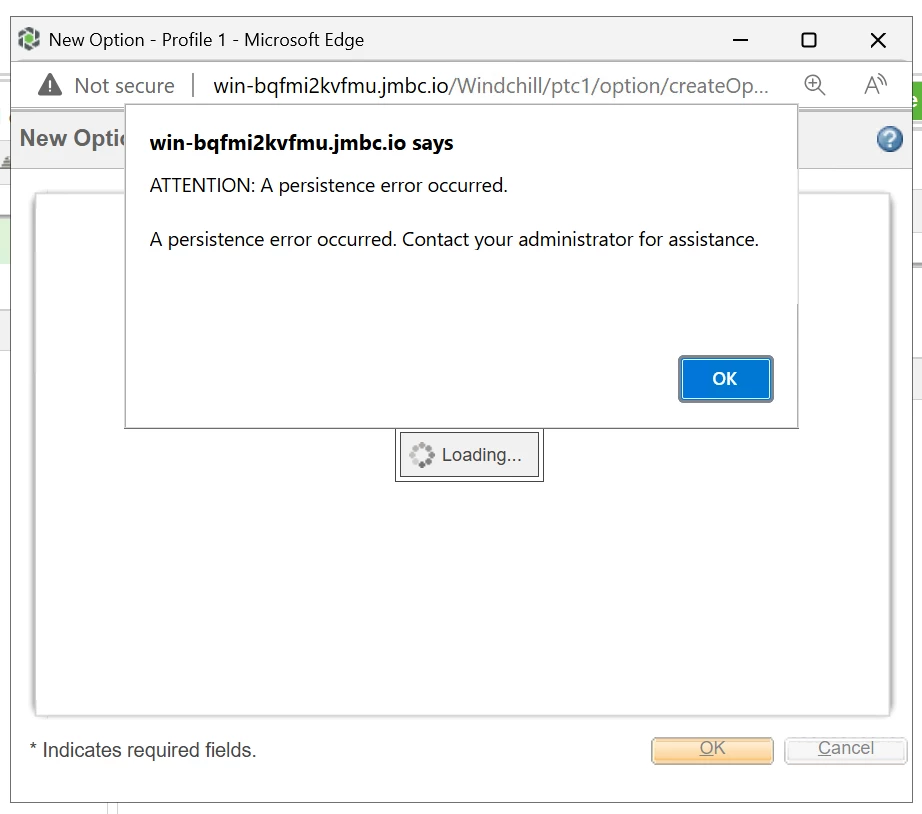

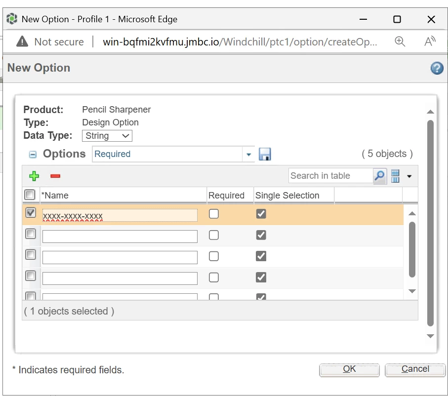

Persistance error
Version: Windchill 12.1
Use Case: Options & Variants
Description:
In Option Pool i want to create a New Option but getting a persistance error as soon the New Option has been given a name, is that SQL DB related??

I do not know much about Options and Variants but the method server log of this event might have more information. Can you look for that?
EC_1058120912-AmethystAuthorAnswer
Sep 30, 2024 9:30 AM UTC
i have found a solution, my sql db on filegroup indx is full and i need to empty it. because i am using sql express
