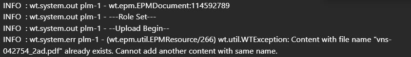

Persistent Request Issue When Updating EPMDocument ID in Java Application
I have a code like this, and I ran it in its current state, and it worked. After that, I changed the ID value in this part ("wt.epm.EPMDocument:114592789") and assigned another EPMDocument ID. Of course, I also changed the file name and file path. When I ran it again, it still tried to send the request using the first information I used. In the console, it gave a warning saying something like "this has already been added" or similar. I tried a few more IDs, but each time it attempted to process using the first information I sent. Is this problem due to Eclipse, or is there an issue in the code? Can you help me?

Aug 30, 2024 8:27 AM UTC
Check in Windchill if there is a document with the same file name. Windchill does not like the same file name even if they are different by content , and even if it was attached to different objects. Try this manually and see for yourself. Your file names are the same for the 1st upload and 2nd, going by the log.

Sep 2, 2024 7:49 AM UTC
I've successfully implemented file deletion, but when I check MethodServer, it keeps logging the same message, repeatedly attempting to send the part with the EPMDocument ID 114592789. This was the ID I tried to process when I first ran the application. Since then, I've attempted to attach parts to different EPMDocument IDs like 129025898, but MethodServer keeps making requests for the initial ID. It continuously shows the same log. Is there a way to clear the MethodServer or bypass this issue?
