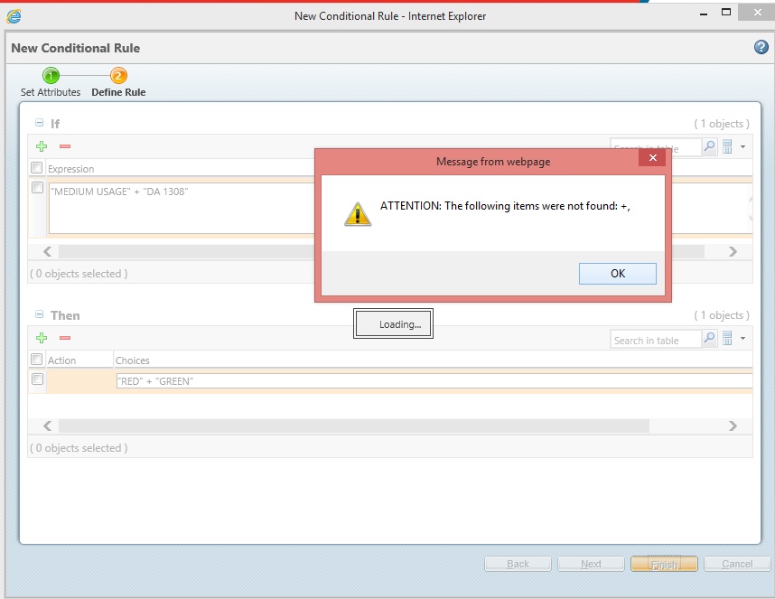

Platform Structures : Unable to add multiple choice using AND, OR logical operators in 'THEN' section of 'Conditional Rules'
  • October 7, 2014
  • 1455 views
This is a query regarding newly introduced 'Platform Structures' module with Conditional Rule capability.
For 'New Conditional Rule' wizard,
* In 'IF' section, user can select multiple choices or choices from different options - using AND, OR, NOT logical operators.
* But this is not valid while adding multiple choices or even choice from different options in 'THEN' section.
It seems, system validator fails to identify logical operator for this wizard.
Has anyone observed this earlier while building Rules for Product Configuration ?
7-Bedrock
June 12, 2018
Depends on the action for the consequence (THEN) part. Use comma for separation.
Example:
THEN INCLUDE a,b,c
