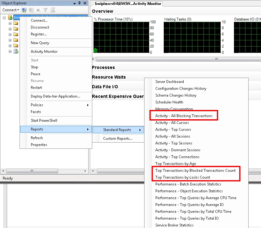

Do you see anything in the activity monitor? We experienced a deadlock scenario with severe performance issue. This was due to a deadlocked caused by publisher queue.
We used some of the reports from SQL Server to trace back to the transaction.
Upgrade Manger deletes/creates indices at its course of run. Did you notice any error in upgrade manager in this step?
