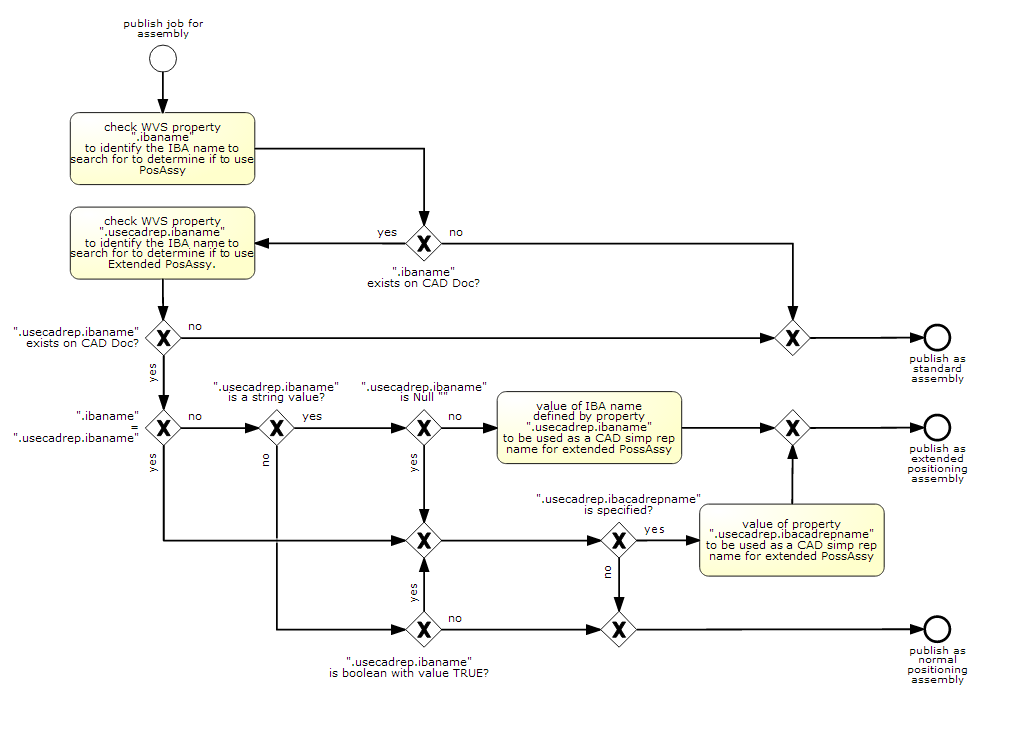

thanks for the link, it helps a bit. I found this page a bit of a challenge to fully understand however. See attached diagram which represents my interpretation of this information in a more digestable format. Confirmation appreciated.
Is it therefore true to say for extended positioning assemblies the CAD worker will only download models which are affected by the assembly features? So If I have a 1000 part assembly to publish, and only one of the lowest level assemblies with just 2 parts has a feature cut, then only this one low level assembly (With it's 2 parts) will be downloaded when publishing the the MA?
But if a feature cut appears in the top level assembly, all 1000 parts will need to be downloaded to publish as extended positioning assembly. In this instance it would therefore take roughly the same amount of time to publish as a standard job? Or is the system smart enough to know which of the 1000 parts are affected by the assembly cut, and just download those with affected geomoetry?
Does the same apply to additive assembly features?
Regards
Darren
June 30, 2014
There were multiple presentations on this topic last year at PTC Live Global, and several more this year. (Last year's presentations are available on the PTC User website. This year's are currently only available to those who attended.)
Basically, a positioning assembly will only load the top level assembly file on the publisher. It will NOT download or open any of the dependents (parts or assemblies). This makes publishing very fast. For extended positioning assemblies, the entire assembly and all related parts need to be downloaded and physically opened on the publisher, so the load time advantage is lost, but the file(s) produced are still much less than what would be produced if positioning assemblies weren't used at all.
