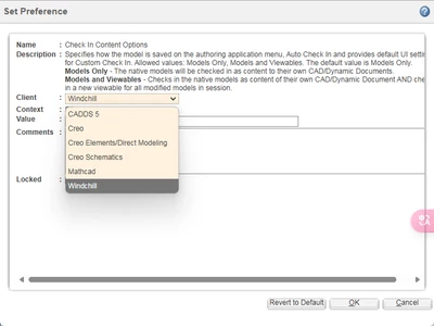

In the preferences for option 'Check In Content Options' below applications are supported.
My suggestion was to have SolidWorks included in these too.

I see now. Yes not listed. If you are suggesting that this be added, I would put a post in the ideas section. Curious why SolidWorks was not listed but I gather there was a technical reason. Have you considered using server side publishing? You can have it publish on checking from that side and it has some other nice benefits.
