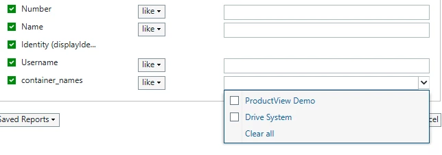

Version: Windchill 13.0
Use Case: User wants to create a report using report builder, that allows to specify container, but by using dropdown, not by typing manually the container name. This behaviour is documented in case CS256206 and it seems nothing was done to provide the solution for that, so asking if anyone found workaround.
Description:
If report builder is not capable of doing something like this, then is there a way to prepare JSP input page that will have some kind of container picker and pass the information to actual query builder logic? I've seen some custom-input pages but they are really odd and difficult to understand.

This took way longer than I expected, but this was also because of work on other projects and other various frustrating and miserable things in the meantime. Anyway, here's a bit of PowerPoint presentation showing more or less how this can be done.
I don't go into deeper details, because I can't imagine anyone else needs something like this, but even if, I'm open to explain it if someone needs something like that.

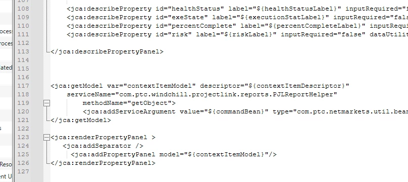

Exposed reports do allow for an input page: https://support.ptc.com/help/windchill/r13.0.2.0/en/#page/Windchill_Help_Center/reportmgmt/ReportMgmtReportEdit.html
I think its possible (not sure off top of my head) to supply a custom JSP page as input. That page would render the drop down list for contexts that the user can select and pass the value as a parameter to a report.

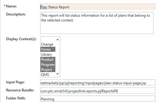

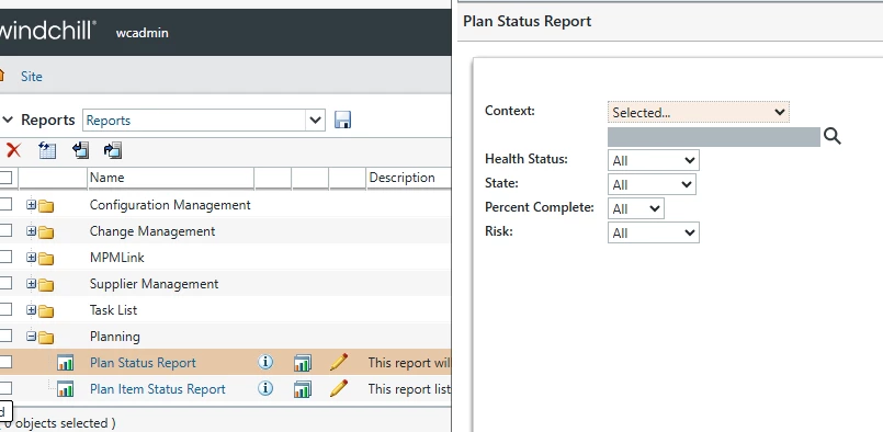

What I was looking for was something more like this Plan Status Report from the Planning folder in Reports page.
It also points to some custom JSP which even has picker for context, but to me it looks like one of these reports driven by awful Info-Engine tasks that I really don't want to do.
