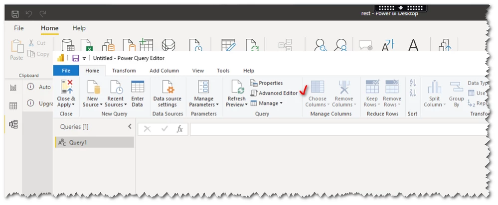

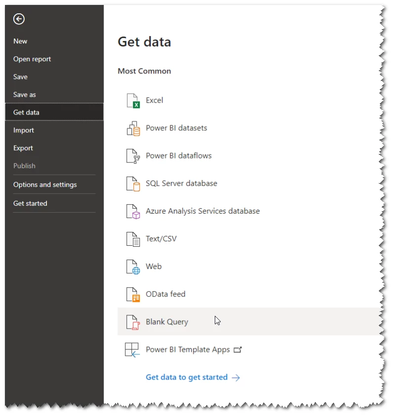

1. Start with a blank web query in PowerBI
Start with a blank web query in PowerBIStart with a blank web query in PowerBI
2. Use the Advanced Editor to write web query from scratch
Use the Advanced Edit to write a web query from scratchUse the Advanced Edit to write a web query from scratch

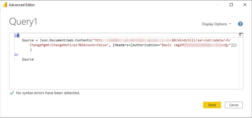

3. Only need to call the REST Service (using an OTB odata REST here) and provide an authentication
Make your REST call and provide AuthenticationMake your REST call and provide Authentication
let
 Source = Json.Document(Web.Contents("https://<myhost>:80/Windchill/servlet/odata/v5/ChangeMgmt/ChangeNotices?%24count=false", [Headers=[Authorization="Basic <mybasicauth>"]]))
in
 Source
4. Transform and present the data how you want in the PowerBI UI
How would go about having a REST endpoint push? Once it's in Power BI you can refresh to pull the latest data anyway.
Main downside to this method is storing credentials in the pbi web query, if you want to share the analysis then publish it, instead of sharing the Power BI file itself
