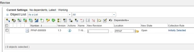

We have a similar process and our PPAP Documentation is associated to the WTPart via the Reference Documents relationship.
Set your Revise Collector preference to not include related parts when revising.

May 6, 2022 8:47 PM UTC
Yes, if you look at an earlier rev of a part, you may see the latest revision of the PPAP.  For our use case, we do not revise PPAP's once approved, we issue another PPAP for a new revision.  So as my part history grows, my reference document library grows.  Fortunately, we name our PPAP documents with the part revision included.  So if i am looking at a Rev 3 Part, I can see my Rev 1, Rev 2 and Rev 3 PPAP history all in one shot
