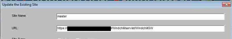

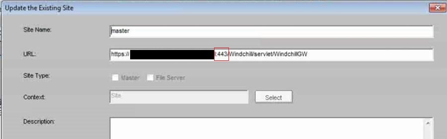

We were able to get this fixed. It was surprisingly small but took nearly 2 weeks to find the root cause.
Our sub-contractor KPIT helped us evaluate the source code with PTC. We found a line called “fullUrl.startsWith(tempUrl)” in StandardUploadToCacheService.java. We looked at this URL in the Vault configurations of the server that was not working (Production) versus the test server that was working for the uploads from Creo 2 M110. We noticed that the URL of production had the port number at the end of the URL, “:443”, but the test server did not.
The full URL is like https://hostname/....../Windchill/servlet/WindchillGW/wt.fv.uploadtocache.DoUploadToCache_Server/doUploadToChache_Master?mk=wt.fv........
The code does a test to see if the full URL matches the URL supplied by this configuration in the UI, it was failing to match because the :443 is not in the full URL. We removed the :443 from Production and the test using Creo 2 M130 and Creo 2 M110 are successful.
Before fix:
After fix:
