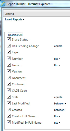

MarcoTosin
Mar 11, 2016 7:30 AM UTC
In Windchill 11.0 checked every columns is default for saved reports.
Here you can read some more information on new query builder features you can find in Windchill 11.0
BIG Query builder news on Windchill 11.0
