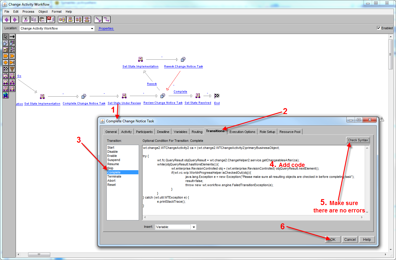

Following should addrees this
  • Navigate to Organizations―Utilities―Workflow Template Administration―Change Activity Workflow―Edit
  • Open “Complete Change Notice Task” activity icon and add following code under “Transitions”―”Complete”
wt.change2.WTChangeActivity2 ca = (wt.change2.WTChangeActivity2)primaryBusinessObject;
try {
wt.fc.QueryResult objQueryResult = wt.change2.ChangeHelper2.service.getChangeablesAfter(ca);
while(objQueryResult.hasMoreElements()){
wt.enterprise.RevisionControlled obj = (wt.enterprise.RevisionControlled) objQueryResult.nextElement();
if(wt.vc.wip.WorkInProgressHelper.isCheckedOut(obj)){
java.lang.Exception e = new Exception("Please make sure all resulting objects are checked in before completing task");
result=false;
throw new wt.workflow.engine.FailedTransitionException(e);
} catch (wt.util.WTException e) {
e.printStackTrace();

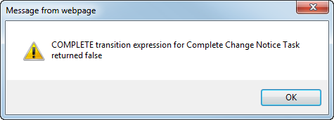

  • Following pop up will show up to users preventing them from completing task if any resulting object is found checked out

Folllowing exception was an attempt for that, but it does not seem working. I have seen it working in other custom workflows for transitions in activity robots though.
