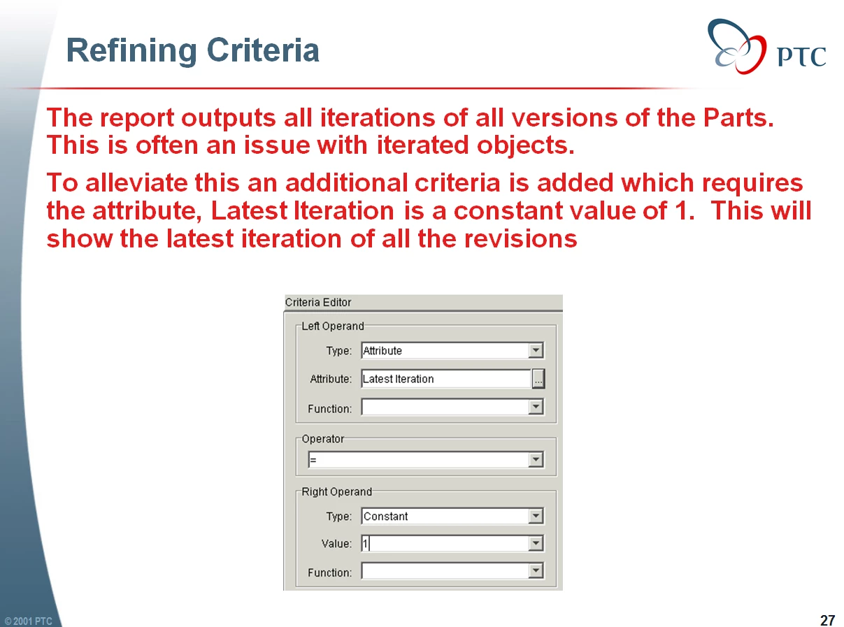

I hope this hasn't already been addressed. If so, then maybe I can get a
quick refresher.
Is there a way to use Query Builder to get the latest version only of a
document number without using lifecycle state or some other criteria? I
want to mimic the behavior of the "Go to Latest" link using query builder,
but I am not sure how Go to Latest works at the database / object model
level. Can anyone explain how Go to Latest actually works (i.e. what
tables are involved in finding that latest among multiple revisions where
each revision has its own "latest" iteration)?
Thanks.
Al Anderson
22-Sapphire I
May 17, 2011
It's unbelievable that Latest Rev is not there to select.
You have to use Sub Select on Maximum of VersionSortID
