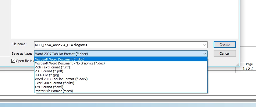

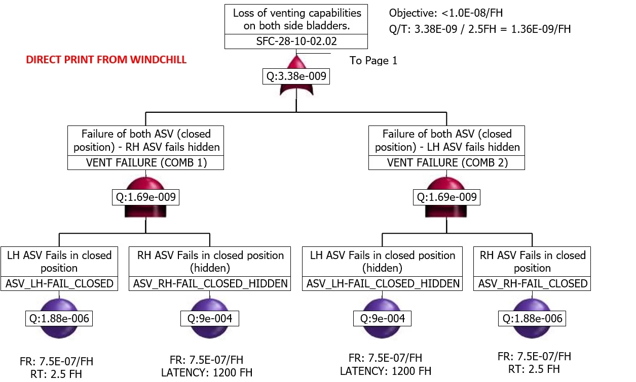

I am trying to figure out how to incorporate a FTA into a safety analysis I am making in a separated .doc file. I do not want to make it using screenshots or similar because I need the text within the tree to be searcheable once the analysis is saved in pdf. format.

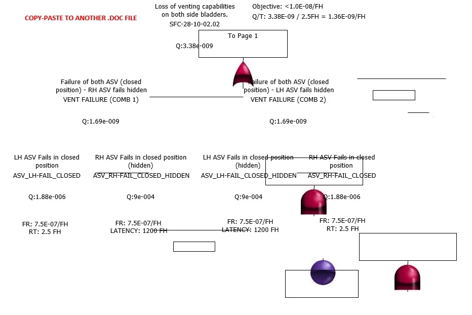

What I have done so far is to print the tree to file .doc. The printing is ok but I am not able to copy the figures into other .doc file, they are pasted as an unreable mix of boxes and lines. See attachments.

Can you print to PDF and then open the PDF using Word? Or open the PDF using a more advanced PDF editor and try saving to a different format from the PDF editor?
Can you save the Windchill has HTML and then import the HTML?

Opening the pdf file using Word does not work, the FTA becomes a mess after convertion.
There is no option to print the FTA in HTML (see attached shot).
I have not tried with more advanced pdf edition, there should be a direct option to do it I guess.

Its a webpage so you should be able to do a save as html from your browser. In most browsers this is a CTRL-S. You could then try and open the html in word.
